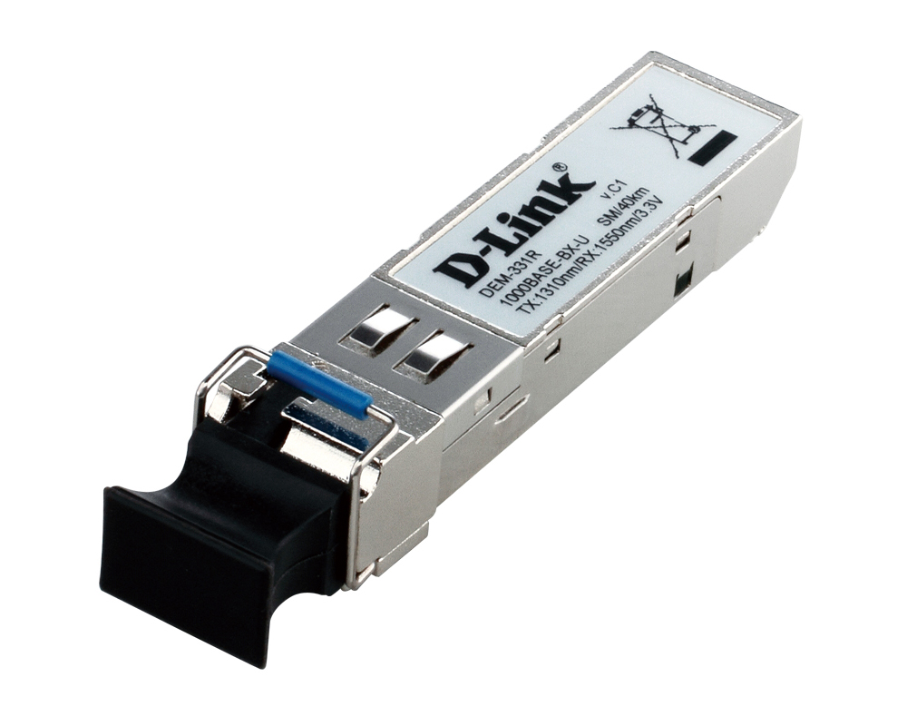

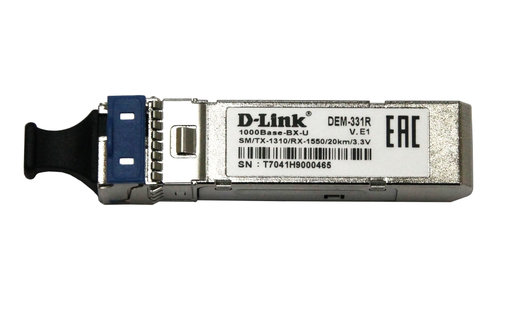

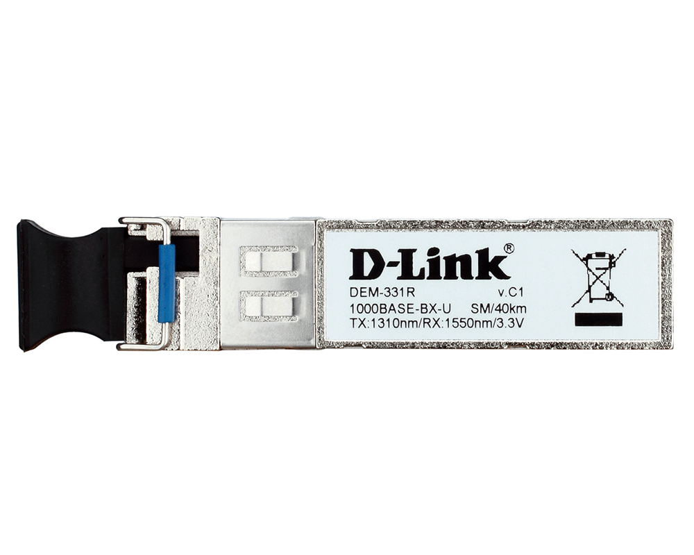

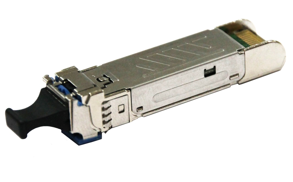

DEM-331REOL EOS
1000Base-BX-U (Tx:1310 nm, Rx:1550 nm) Single-Mode WDM SFP transceiver

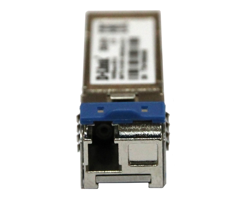

The DEM-331T/DD and DEM-331R/DD transceivers combine transmitting and receiving signals onto one fiber strand using two wavelengths. These transceivers are used in pair. At one end, one transceiver uses one wavelength to transmit and a second wavelength to receive. At the other end, the other transceiver flips that relationship.
Standard Compliance
The DEM-331T/DD and DEM-331R/DD transceivers use standard simplex LC connectors for fiber cable connection. They conform to industry standards and are interoperable with D-Link Gigabit switches. Hot-swap capability allows network administrators to plug or unplug them from the SFP slots without having to turn off the power of the connected device.

• IEEE 802.3z 1000Base-BX-U
Wavelength
• Tx: 1310 nm, Rx: 1550 nm
Data Rate
• 1.25 Gbps
Connector
• Simplex LC
Fiber Type
• 9/125 um Single-mode Fiber
Maximum Fiber Cable Length
• 20 km (DEM-331R/20KM)
• 40 km (DEM-331R)
Transmit Power Range
• -3 to -9 dBm (DEM-331R/20KM)
• -5 to 0 dBm (DEM-331R)
Receive Power Range
• -3 to -22 dBm (DEM-331R/20KM)
• -3 to -24 dBm (DEM-331R)
Sensitivity
• -22 dBm (DEM-331R/20KM)
• -24 dBm (DEM-331R)

Dimensions
• 55.4 mm x 13.7 mm x 8.5 mm
