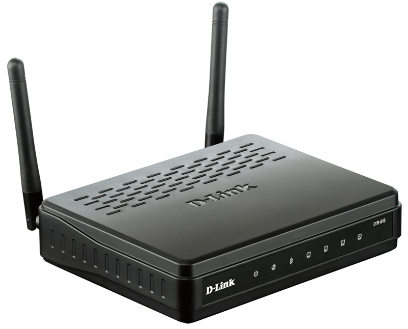

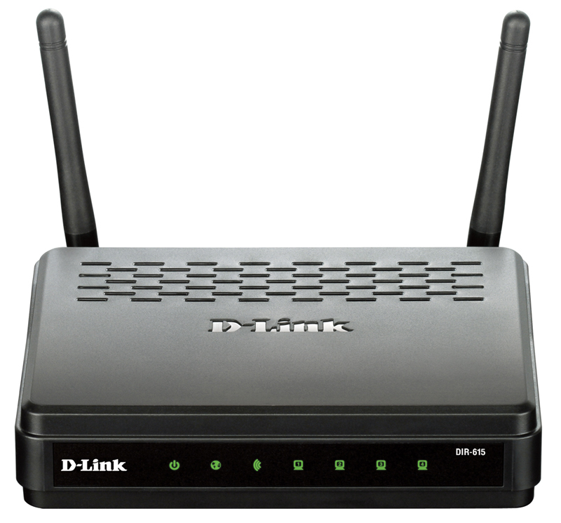

DIR-615/FB1/U1AEOL EOS
Wireless N300 Router with Fiber WAN Port
Description

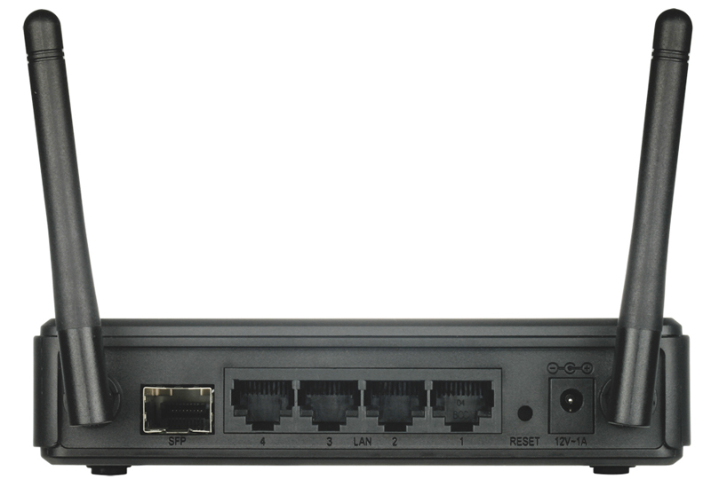

4-port Switch
The built-in 4-port switch enables you to connect Ethernet-enabled computers, game consoles, and other devices to your network.
Wireless Interface
Using the DIR-615 device, you are able to quickly create a wireless network at home or in your office, which lets your relatives or employees connect to your wireless network virtually anywhere (within the operational range of your wireless network). The router can operate as a base station for connecting wireless devices of the standards 802.11b, 802.11g, and 802.11n (at the rate up to 300Mbps).
The router supports multiple functions for the wireless interface: several security standards (WEP, WPA/WPA2), MAC address filtering, WPS, WMM.
Security
The wireless router DIR-615 includes a built-in firewall. The advanced security functions minimize threats of hacker attacks, prevent unwanted intrusions to your network, and block access to unwanted websites for users of your LAN.
Easy Configuration and Update
You can configure the settings of the wireless router DIR-615 via the user-friendly web-based interface (the interface is available in several languages).
Now you can simply update the firmware: the router itself finds approved firmware on D-Link update server and notifies when ready to install it.

Hardware
WAN Interface
• 1 10/100Mbps SFP port for fiber optic connector
LAN Interface
• 4 10/100BASE-TX Ethernet ports
