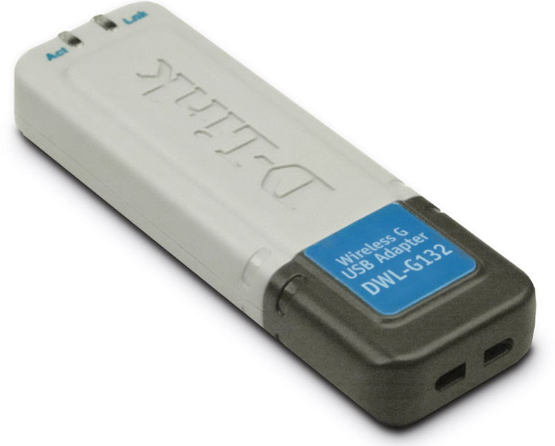

The D-Link AirPlusXtreme G DWL-G132 is a high-performance wireless USB adapter for desktop and laptop computers. Complying with the 802.11g WLAN standard, this adapter provides wireless speeds of up to 54Mbps and 108Mbps Turbo mode. It's an ideal solution that offers advanced security features, easy setup and an upgrade to a fast, new technology while protecting your past investments through interoperability with earlier 802.11b standard equipment.
108Mbps Turbo Mode Data Transfer Rate. Powered by D-Link 108G Technology, this adapter is capable of delivering maximum wireless signal rates of up to 108Mbps when connected to other D-Link AirPlusXtreme G products. When operating with other 802.11g-compliant equipment, this adapter can transfer data at up to 54Mbps speed, and is an ideal device for wireless applications like large file transfer and streaming video.
Seamless Operation. The DWL-G132 is backward compatible 802.11b devices, so you can maintain connectivity with your existing equipment when you upgrade your network to higher-speed 802.11g. This adapter can be used in the peer-to-peer mode (ad-hoc) to connect directly to other wirelessly enabled computers, or in the client mode (infrastructure) to communicate with other users through an access point or router.
Easy Setup. The DWL-G132 includes an intuitive configuration utility that allows you to discover and connect to other wireless networks in nearby areas. In addition, the utility can also create detailed connectivity profiles of networks you frequently access. You can also enable support for WPA/WPA2 and 802.1x for enhanced data encryption and user authentication.
Compact and Convenient. The DWL-G132 can be directly plugged to your computer's USB port or through a USB cable with an adapter cradle at the other end. This allows you place the adapter on a desktop or any flat surface at a position for best signal reception. Compact in size, robust in speed the DWL-G132 Wireless USB Adapter is great for travel and a convenient solution for providing high performance wireless connectivity to your desktop or notebook PC.
