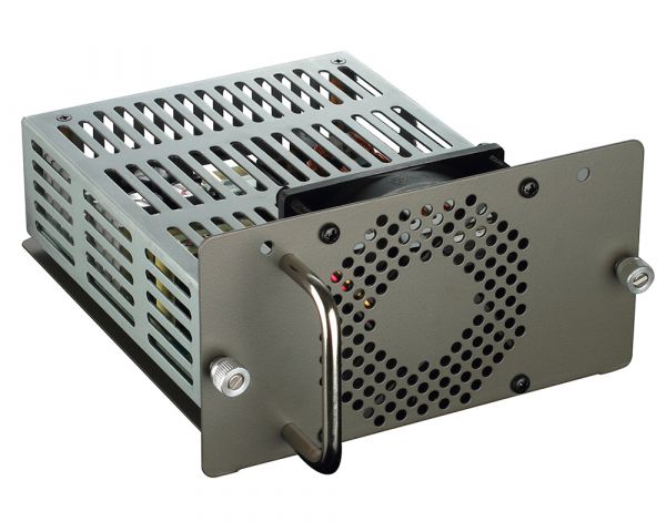

Redundant Power Supply of Chassis-Based Media Converter
Kirjeldus
When the chassis is equipped with two DMC-1001 power supplies, both power supplies are switched on and share the current load. In case that one of them should fail, the other will instantaneously take 100% of the load without any loss. Similarly, if one power supply is removed from servicing, it can be switched off and removed while the chassis continues functioning.
