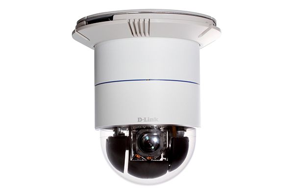

![](/up/prod/600/DCS-6616_A1.jpg)
DCS-6616מיועד לפרויקטים
תאור
Round the clock
High-speed dome network camera with 12x optical zoom DCS-6616 provides an overview of a large territory, including in low light conditions. With built-in sensor Sony Super HAD-II 1/4 "CCD IP-Camera DCS-6616 can transmit high-resolution video 650 TVL with excellent image quality. Built-ICR-filter allows the camera to obtain high quality images in bright conditions, and in the dark. In the daytime, ICR-filter is in place and does not transmit infrared radiation, which provides high-quality images. At night, the ICR-shifting filter, which allows the camera to use infrared light for shooting in low light conditions.
Multi-functional PTZ (tilt / pan / zoom)
IP-Camera DCS-6616 has a wide range of functions PTZ, providing an overview of a large area. With 360 degrees of rotation can easily observe the surrounding area, and 12x optical zoom with auto focus delivers image detail. The speed of rotation varies and is proportional to the scaling factor for the accurate control of camera movement. PTZ Preset point allow the DCS-6616 to move on them and monitor the automatic mode.
The flexibility to connect
The DCS-6616 is equipped with inlet and outlet ports for connection to external devices such as IR sensors, switches and alarm relays. The camera has audio input and output ports, and video output for direct connection to a TV to watch in real time.
Applications WDR (Wide Dynamic Range)
WDR function provides clear images even under backlight behind the object of observation, where the light intensity can vary considerably. This makes the DCS-6616 an ideal solution for surveillance in high-contrast lighting. For example, when installing the unit in the room DCS-6616 adapts to the conditions of intense sunlight, falling from a window, which makes this camera ideal for security.
Multiple video streams
DCS-6616 supports simultaneous transmission of video streams in formats H.264, MPEG-4 and MJPEG, to provide high quality images and with efficient use of bandwidth. MJPEG format ensures the integrity of files and is ideal for situations requiring high image detail. H.264 video compression and MPEG-4 files possible to obtain small size, which is useful for long-term record, or when used in networks with low bandwidth. In addition, DCS-6616 supports multicast transmission of H.264 and MPEG-4, which allows users to browse videos by connecting to the multicast streams in the network.
