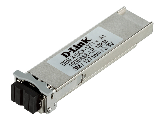

10G XFP CWDM transceiver for single-mode fiber optic cable (wavelength 1271nm, up to 10 km)

Standard
• Standard compliance: IEEE-802.3ae, 10GBASE-SR
• Tranceiver type: XFP
• Fibre Channel FC-PI Standard: 1200-SM-LL-L
• Fiber Media Support: Single-Mode
• Distance capacity: 10km
Features
• Hot Pluggable
• MSA Compliant
• RoHS Compliant
Speed
10Gbps
Interface
• Connector: Duplex LC Connector
• Single/Bi-Directional: Single Direction
• Wavelength: 1271nm
• Output optical power (TX optical power):
  Max.: 3dBm
  Min.: -2dBm
• Input optical power (RX optical power):
  Max.: 0.5dBm
  Min.: -12.6dBm
• Sensitivity: -12.6dBm
• Cable type: Single-mode 9/125 um fiber
