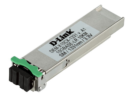

10G XFP CWDM transceiver for single-mode fiber optic cable (wavelength 1331nm, up to 10 km)
Kur iegādātiesApraksts
D-Link’s 10G CWDM SFP+/XFP Module Series consists of hot-swappable transceivers that plug into SFP+ or XFP slots on switches and support 10G Ethernet. These CWDM transceivers can be used with MUX/DEMUX equipment to combine the Ethernet signals of multiple switch ports into a single fiber cable, drastically cutting the infrastructure costs involved with long distance fiber communication. Available in multiple models to support different wavelengths, these transceivers are ideal for ISP and campus applications.

Standard
• Standard compliance: IEEE-802.3ae, 10GBASE-SR
• Tranceiver type: XFP
• Fibre Channel FC-PI Standard: 1200-SM-LL-L
• Fiber Media Support: Single-Mode
• Distance capacity: 10km
Features
• Hot Pluggable
• MSA Compliant
• RoHS Compliant
Speed
10Gbps
Interface
• Connector: Duplex LC Connector
• Single/Bi-Directional: Single Direction
• Wavelength: 1331nm
• Output optical power (TX optical power):
Max.: 3dBm
Min.: -2dBm
• Input optical power (RX optical power):
Max.: 0.5dBm
Min.: -12.6dBm
• Sensitivity: -12.6dBm
• Cable type: Single-mode 9/125 um fiber
Fiziskie raksturlielumi
Operating
• Power: 3.3V
• Maximum input current:
3.3V: 500mA
• Minimum power budget: 10.6dB
• Maximum power budget: 15.6dB
• Heat generated: 5.94kJ/h
Reliability
MTBF (hours): 818,000
Physical and Environment
• Operating temperature: 0 to 70°C
• Storage temperature: -40 to 85°C
• Operating humidity: 0 to 85%
• Storage humidity: 0 to 85%
• Dimensions: 18.32 x 77.92 x 11.42mm
• Weight: 48.5g
