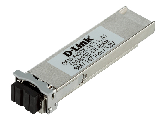

10G XFP CWDM transceiver for single-mode fiber optic cable (wavelength 1471nm, up to 40 km)

DEM-X40CX-1471/A
View from the right
