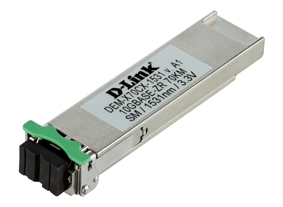

DEM-X70CX-1531  10G XFP CWDM transceiver for single-mode fiber optic cable (wavelength 1531nm, up to 70 km)
Attēli
DEM-X70CX-1531/A
View from the right
