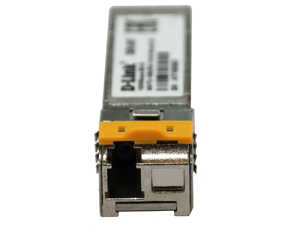

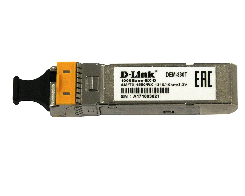

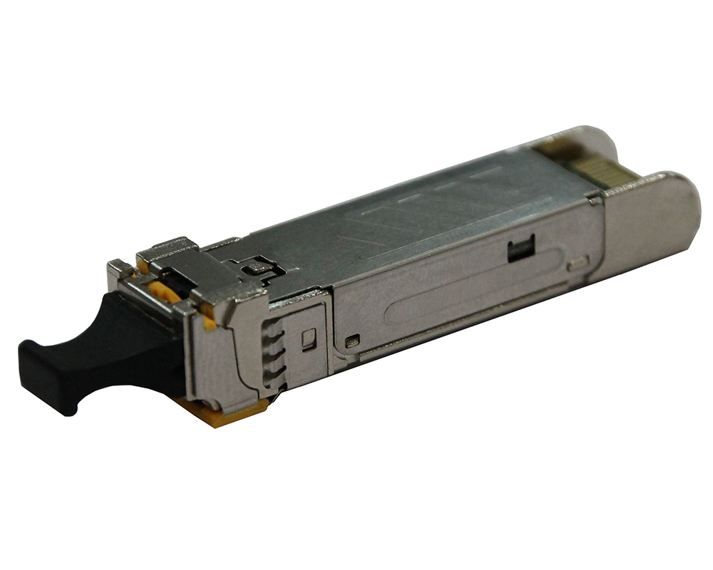

DEM-330TEOL EOS
1000Base-BX-D (Tx:1550 nm, Rx:1310 nm) Single-Mode WDM SFP transceiver (up to 10 km)

The DEM-330T/DD and DEM-330R/DD transceivers combine transmitting and receiving signals onto one fiber strand using two wavelengths. These transceivers are used in pair. At one end, one transceiver uses one wavelength to transmit and a second wavelength to receive. At the other end, the other transceiver flips that relationship.
Standard Compliance
The DEM-330T/DD and DEM-330R/DD transceivers use standard simplex LC connectors for fiber cable connection. They conform to industry standards and are interoperable with D-Link Gigabit switches. Hot-swap capability allows network administrators to plug or unplug them from the SFP slots without having to turn off the power of the connected device.

Standard
• IEEE 802.3z 1000Base-BX-D
Wavelength
• Tx: 1550 nm, Rx: 1310 nm
Data Rate
• 1.25 Gbps
Connector
• Simplex LC

Dimensions
• 55.4 mm x 13.7 mm x 8.5 mm

DEM-330T 1000Base-BX-D (Tx:1550 nm, Rx:1310 nm) Single-Mode WDM SFP transceiver (up to 10 km)
