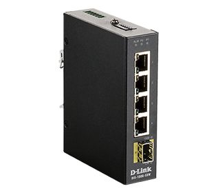

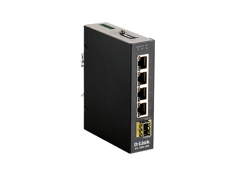

The DIS-100G-5SW Industrial Unmanaged Switch is equipped with 4 10/100/1000Base-T ports and 1 SFP port. This switch features a robust design making it ideal for deployment in industrial and outdoor surveillance settings, capable of withstanding the harshest environments. In addition, the switch is Plug-and-Play, allowing for effortless and swift deployment.
Durable, Reliable, and Efficient
The DIS-100G-5SW switch is housed in a highly resistant IP30-rated metal casing to protect the switch from harsh environmental conditions. The high electromagnetic compatibility (EMC) protects the DIS-100G-5SW from unwanted effects when operating in environments with strong electromagnetic interference. Meanwhile, the fanless design extends the life of the DIS-100G-5SW while also being able to operate in a wide temperature range from -40 В°C up to 75 В°C. For increased flexibility, the DIS-100G-5SW can also be mounted on a DIN rail or conveniently mounted on a solid surface wall. In addition, the DIS-100G-5SW supports dual power input which allows for a redundant power supply configuration to make sure the switches continue to operate in the event of a primary power supply failure.
Meanwhile, a powerful IEEE 802.1p Quality of Service (QoS) engine prioritizes network traffic so that time-sensitive data is delivered efficiently, even during bursts of high data traffic. This helps ensure an optimal experience for streaming critical data such as from surveillance and
recognition systems.
