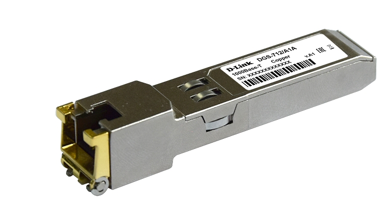

The D-Link DGS-712 1000Base-T Copper Small Form Pluggable (SFP) transceiver is based on the SFP Multi Source Agreement (MSA). This transceiver complies with the Gigabit Ethernet 1000Base-T specification defined in the IEEE 802.3ab standard. The DGS-712 provides data transmission up to 100 meters on the common Category 5 twisted-pair network cable.
The DGS-712 transceiver is cased in an SFP metal housing to increase durability. All D-Link transceivers are hot-pluggable. Hot-swap capability allows network administrators to plug or unplug it from the SFP slot without having to turn off the power of the connected device.
Īpašības
Standard
• IEEE 802.3-2002
• IEEE 802.3ab 1000Base-T Gigabit Ethernet
Transceiver Type
• SFP
Connector
• RJ-45
MDI/MDIX
• Auto MDI/MDIX
Data Rate
• 1.25 Gbps
Maximum Cable Length
• 100 m
Cable Type
• Category 5 twisted-paircable
Supported Features
• Hot swap
• MSA compliant
• RoHS compliant
Physical Parameters
Power Support
• 3.3 V
Supply Current
• 320 mA
Temperature
• Operating: 0° to 70°C
• Storage: -40° to 85°C
Humidity
• Storage: 5% to 95%
Dimensions
• 68.3 mm х 13.7 mm х 8.5 mm
