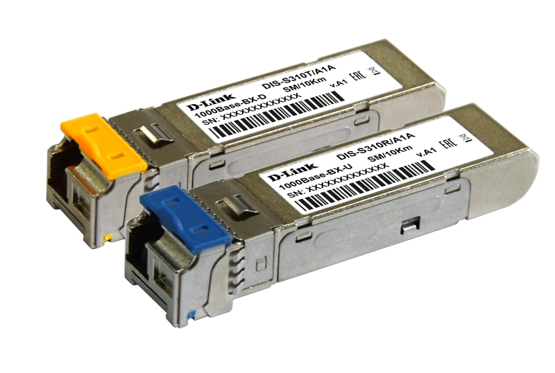

Description
The DIS-S310T and DIS-S310R bidirectional Gigabit SFP fiber transceivers are external transceivers designed for insertion in SFP (Small Form-Factor Pluggable) slots of network devices for transmission and reception of data signals on the fber cables. These transceivers provide the Gigabit operation and physical compactness to deliver the speed, reliable long-distance (up to 10 km) data transfer, and deployment fexibility that today’s fiber networks require. The transceiver is able to operate in a wider temperature range (-40 to 85 T-C).
Ideal for Long Distance Application
The DIS-S310T and DIS-S310R transceivers can be used to connect together switches, servers and fiber modules on a campus or metropolitan area network (MAN). Providing up to 10 km of fiber  cable  distance,  these  highly  integrated  transceivers  offer  low  jitter performance for extended optical link support without any degradation in performance.
Reliable Transmission
The DIS-S310T and DIS-S310R transceivers combine transmitting and receiving signals onto one fiber strand using two wavelengths. These transceivers are used in pair. At one end, one transceiver uses one wavelength to transmit and a second wavelength to receive. At the other end, the other transceiver flips that relationship.
Standard Compliance
The DIS-S310T and DIS-S310R transceivers use standard simplex LC connectors for fiber cable connection. They conform  to  industry standards and are  interoperable with D-Link Gigabit switches. Hot-swap capability allows network administrators to plug or unplug them from the SFP slots without having to turn off the power of the connected device.

DIS-S310T/A
Front view
View from the right
View from the right
Top view
