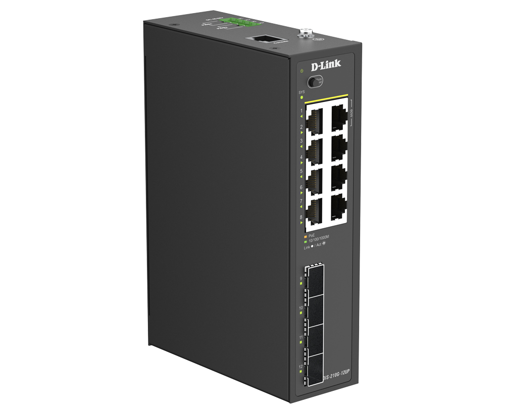

The DIS-210G-12UP Layer 2 Gigabit Industrial Managed Switch is equipped with 6 30 W PoE-capable 10/100/1000Base-T ports, 2 60 W PoE-capable 10/100/1000BASE-T ports and 4 SFP ports. This switch features a robust design making it ideal for deployment in industrial and outdoor cabinet surveillance settings, capable of withstanding the harshest environments. The DIS-210G-12UP switch furthermore integrates advanced management and security functions to provide a complete industrial networking solution.
Durable, Reliable, and Efficient
The DIS-210G-12UP switch is housed in a highly resistant IP40-rated metal casing to protect it from harsh environmental conditions. The high electromagnetic compatibility (EMC) protects the DIS-210G-12UP from unwanted effects when operating in environments with strong electromagnetic interference. Meanwhile, the fanless design extends the life of the DIS-210G-12UP while also being able to operate in a wider temperature range of up to 75 °C. With DIN rail mounting capability, the DIS-210G-12UP can fit seamlessly into your industrial equipment infastructure.

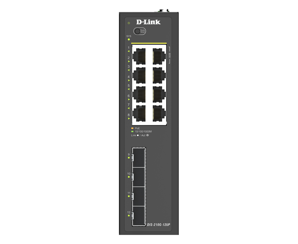

Number of Ports
• 8 10/100/1000Base-T PoE ports
• 4 1000Base-X SFP ports
• RJ-45 console port
Diagnostic LEDs
• Power
• SYS
• Link/Act (per port)
• PoE (per PoE port)

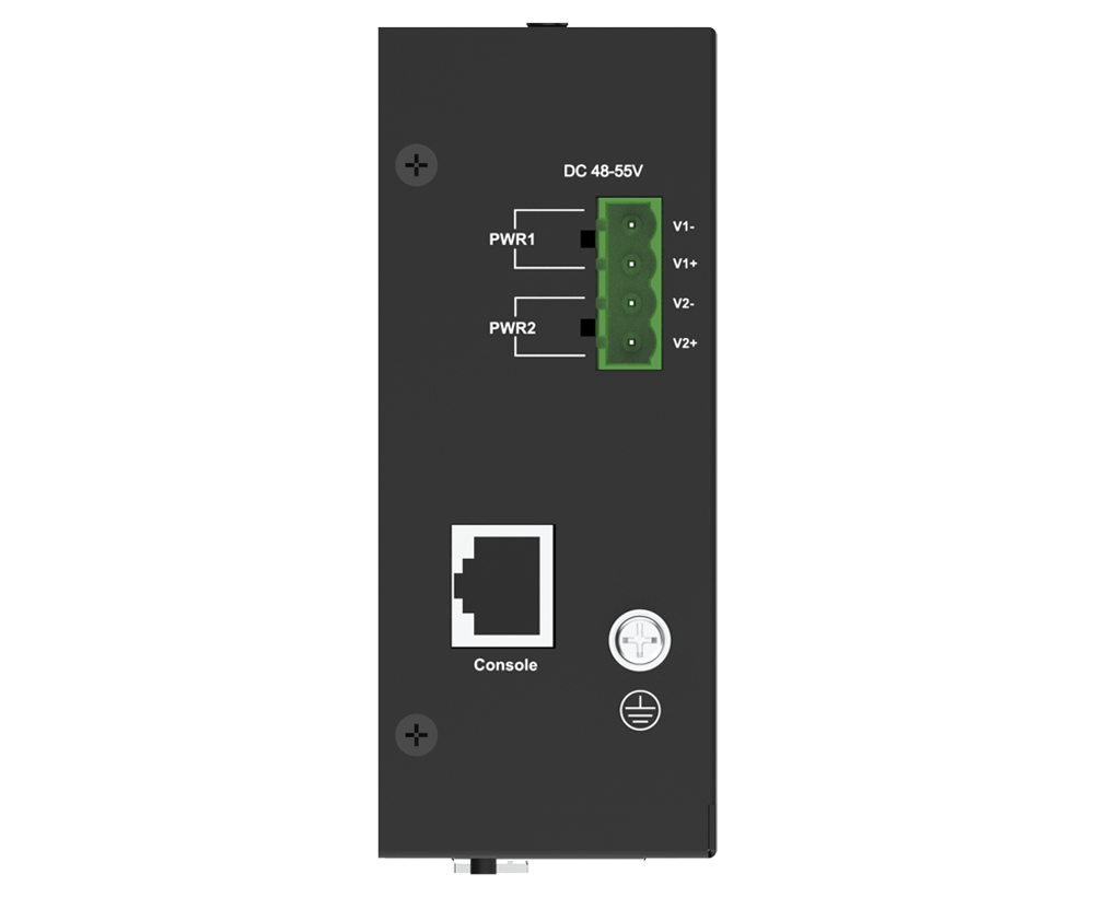

Power Input
• 48-55 V DC / 5.2 A terminal block dual input
