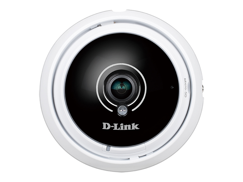

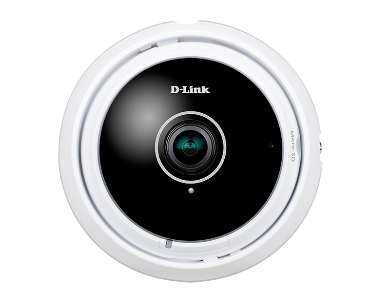

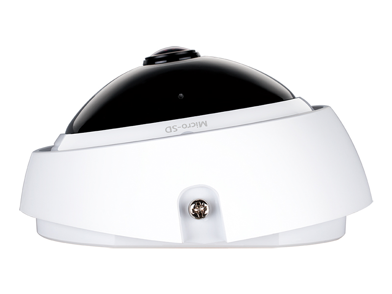

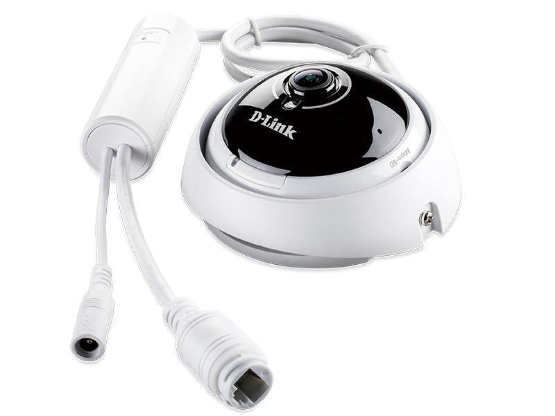

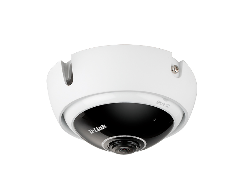

Pictures
DCS-4622/B1
Front view
View from the right
View from the right
Left side view
Вид снизу

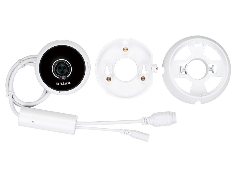

DCS-4622/A1
Front view
View from the right
View from the right
Left side view
Вид снизу
