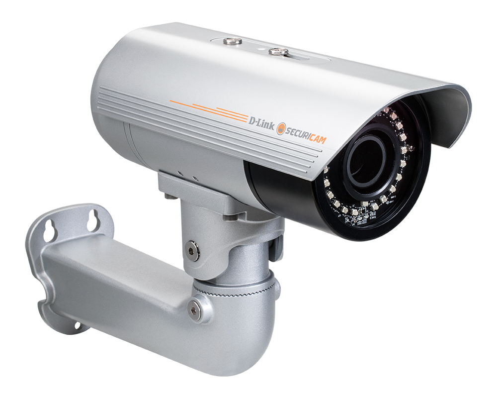

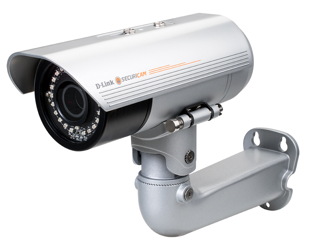

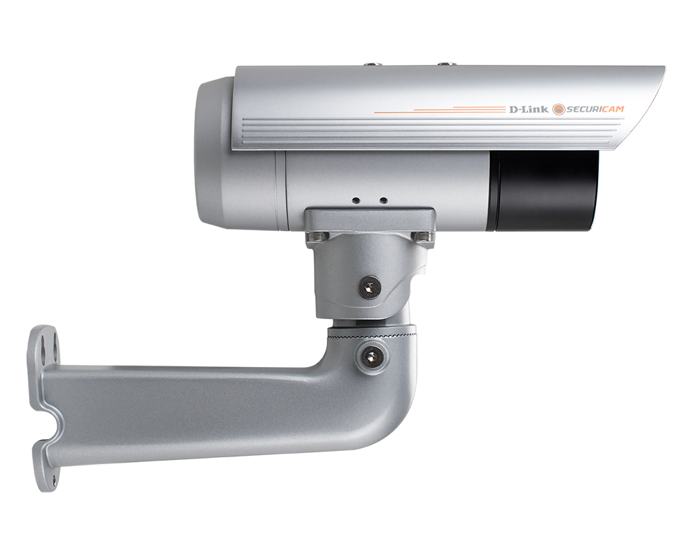

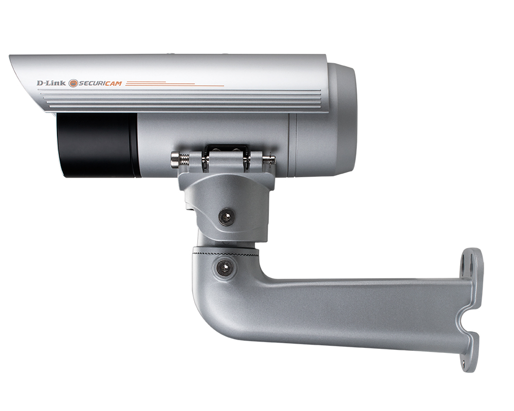

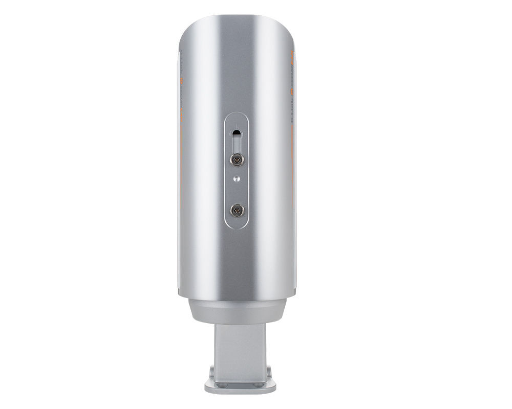

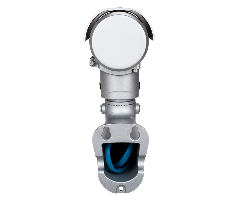

DCS-7517EOL EOS
5 Megapixel H.265 Outdoor Network Camera
Description
The D-Link DCS-7517 5 Megapixel H.265 Outdoor Network Camera is a high definition professional surveillance and security solution suitable for small, medium, and large enterprises. The camera features a progressive scan CMOS sensor and support for H.265 to deliver truly superior quality video in all conditions. Power over Ethernet (PoE) and a rugged, weatherproof design makes this camera extremely reliable and ideal for deployment in any surveillance application.
Built for the Outdoors
Specifically designed for outdoor environments, the DCS-7517 is IP68 certified – one of the toughest Ingress Protection (IP) ratings that is given to products tested to protect against dust and long-term water immersion. A sunshield provides added protection against the elements while blocking out glare, and various mounting options gives installers maximum flexibility for any location. Most importantly, support for Power over Ethernet (PoE) provides power and network connectivity via a single cable – making the DCS-7517 a truly versatile solution that can be used in a wide range of applications.
Advanced Monitoring with H.265 Support

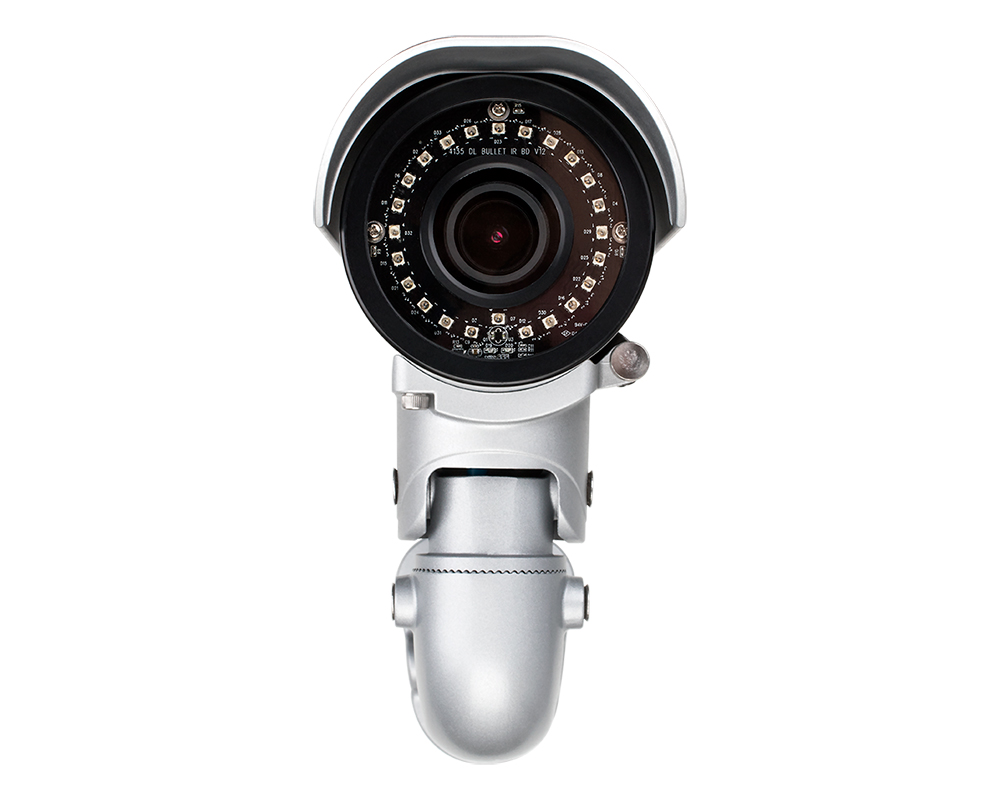

In low-light situations, the IR cut filter automatically slides out of the way to use all available light. The DCS-7517 also has built-in smart IR LED illuminators with a 30-meter range, allowing the camera to keep watch even in complete darkness. To maximize bandwidth efficiency and improve image quality, the DCS-7517 provides real-time video compression using the H.265 and MJPEG codecs. The H.265 codec, or High Efficiency Video Coding (HEVC), uses the latest compression algorithms to save even more space than H.264, for better visual quality and recording performance. These features work together to give you a reliable surveillance camera capable of monitoring an area 24 hours a day – no matter the environment or the application.
Flexible Connectivity
The DCS-7517 has a built-in 802.3af compliant PoE module that simplifies installation by providing power and networking connectivity with a single cable, reducing the need to drill holes or lay additional cabling. In addition, the optional cable harness provides a group of connections such as audio input/output and digital input/output, which supports connections to external triggers such as IR sensors, switches, and alarm relays.

• 1/2.9” 5-Megapixel progressive CMOS sensor
• 30 meter smart IR illumination distance
• Built-in Infrared-Cut Removable (ICR) Filter module
• Minimum illumination:
- 0.01 lux Color mode
- 0.008 lux Black and White mode
- 0 lux Black and White mode with IR LED on
• 10x digital zoom
• Minimum object distance 0.5 m
• 2.8 to 12 mm motorized zoom varifocal DC iris lens
• Aperture: F1.4
• Angle of view (4:3):
- (H) 75° to 24°
- (V) 55° to 18°
- (D) 96° to 30°

Camera Housing
• IP68 compliant weatherproof housing
• Included sunshield

Physical Parameters
Weight
• 1.54 kg (with sunshield and mounting bracket)
Dimensions
• 316.5 x 100 x 249.1 mm (with bracket)
• 223.5 x 97.5 x 90.7 mm (w/o bracket)
