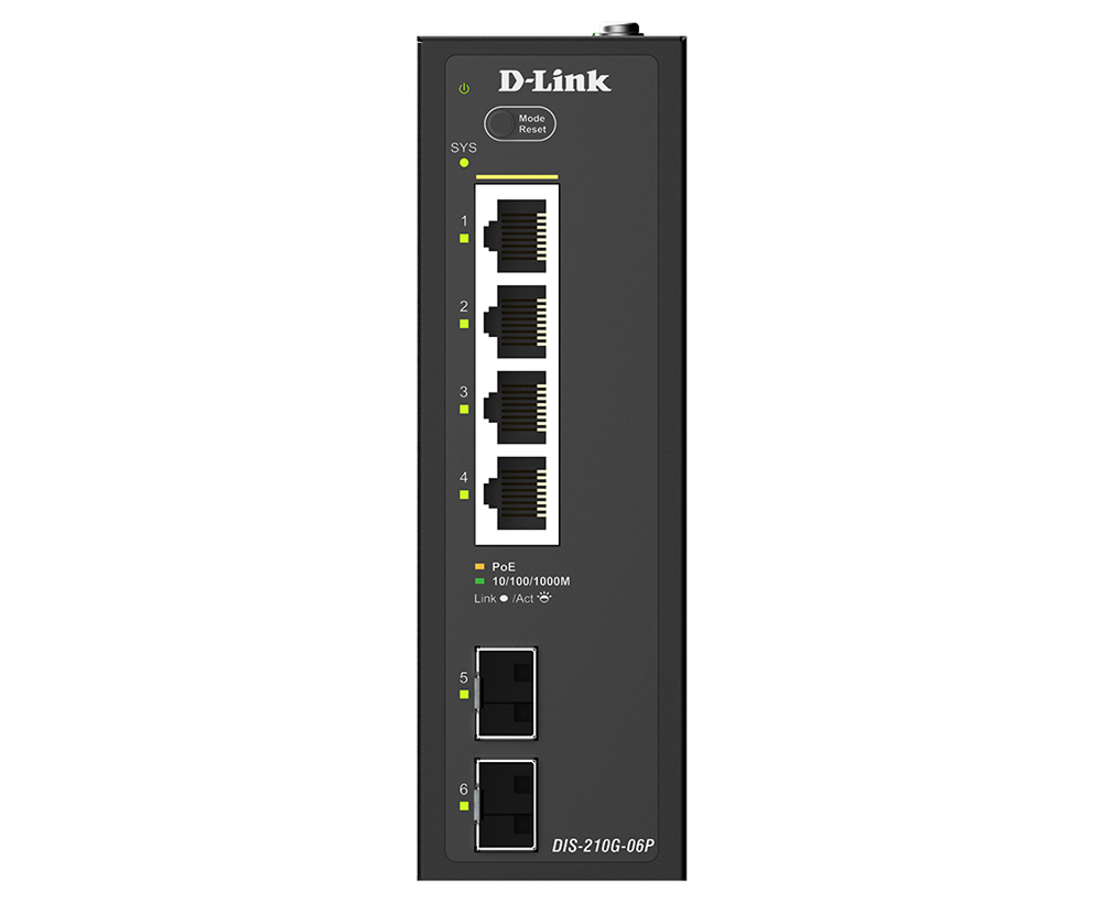

General features
Hardware Version
• A1
Number of Ports
• 4 10/100/1000Base-T PoE ports
• 2 1000Base-X SFP ports
• RJ-45 console port
Diagnostic LEDs
• Power
• SYS
• Link/Act (per port)
• PoE (per PoE port)

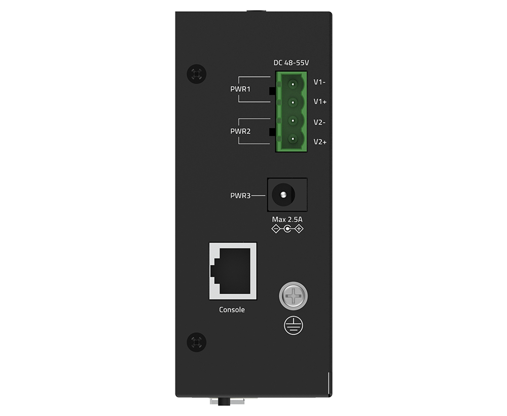

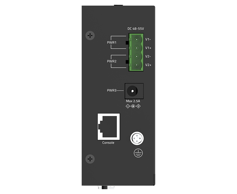

Physical Parameters
Power Input
• 48-55 V DC / 2.7 A terminal block dual input
• External power adapter* (48-55 V DC / 2.5 A output)

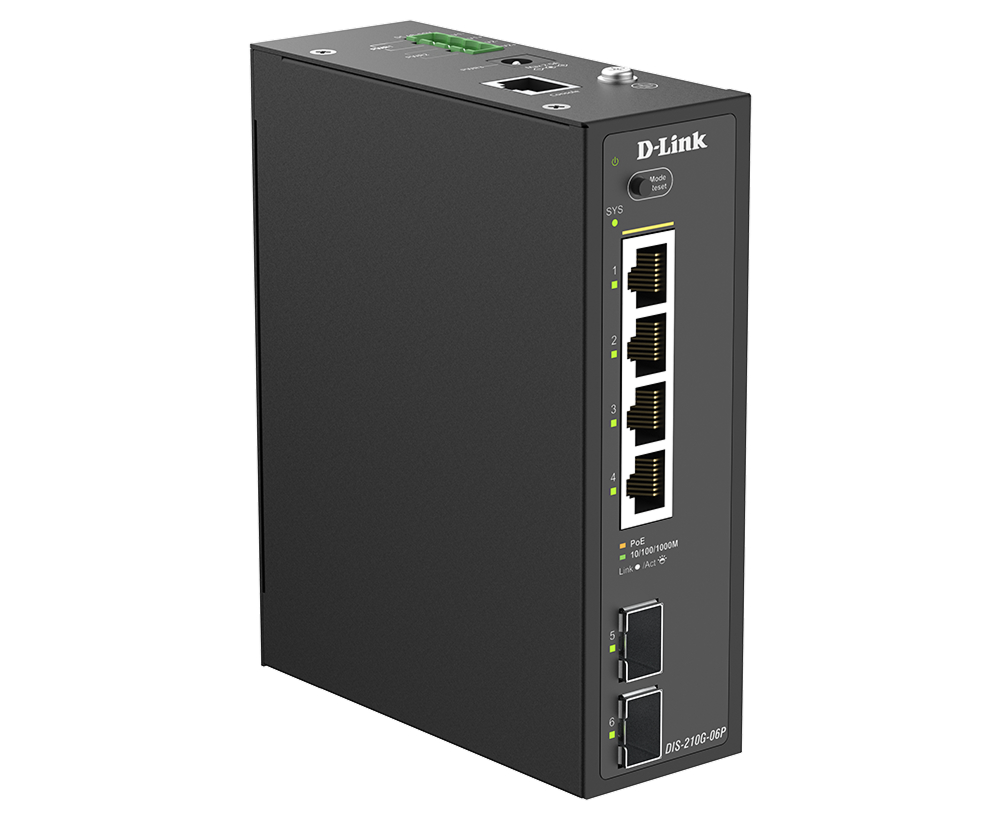

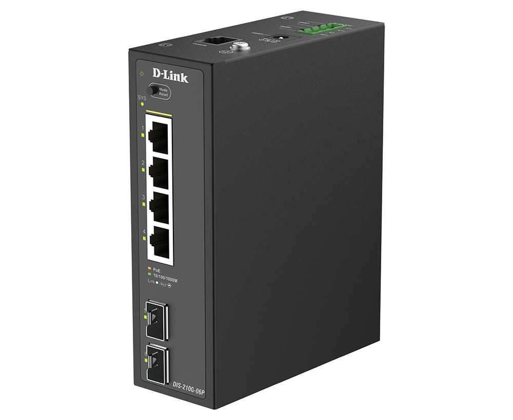

DIS-210G-06P  Layer 2 Industrial Managed Switch with 4x10/100/1000Base-T PoE Ports and 2x1000Base-X SFP Ports

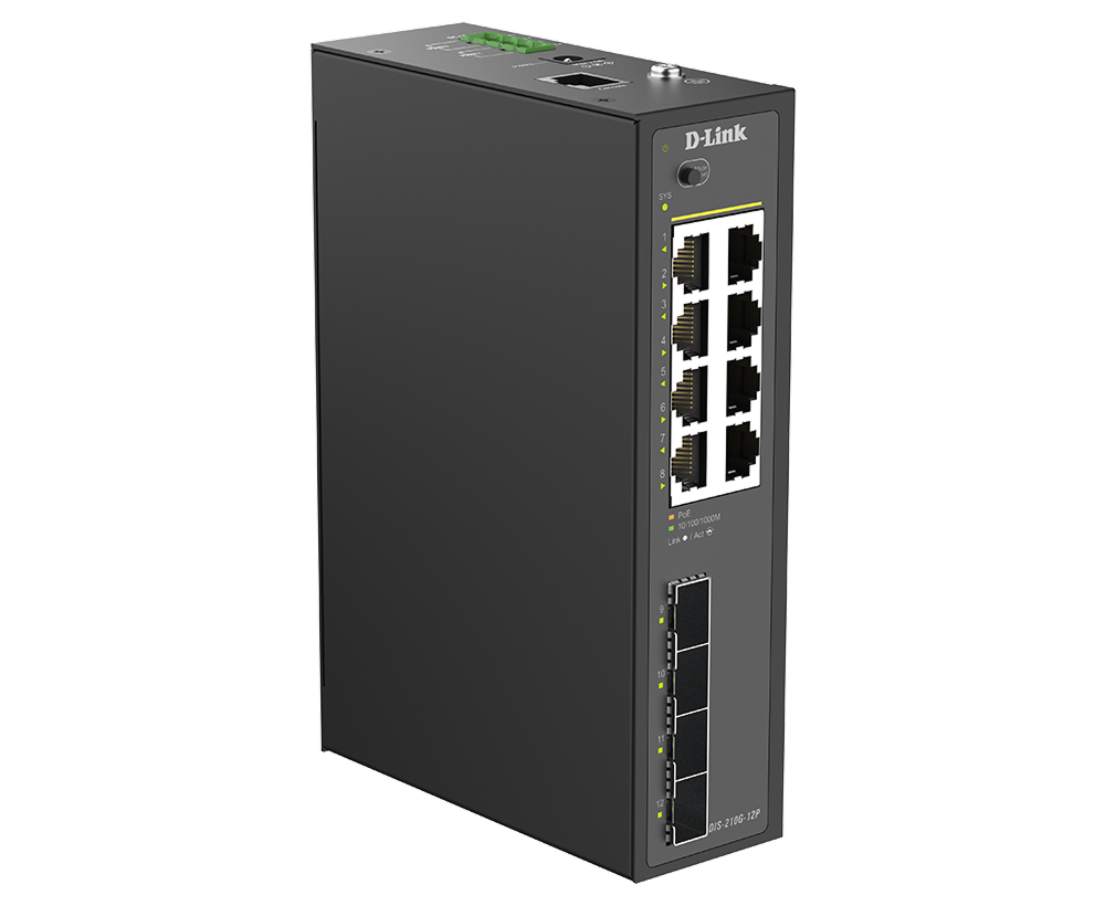

Pictures
DIS-210G-06P/A1
Front view
View from the right
Left side view
Top view
