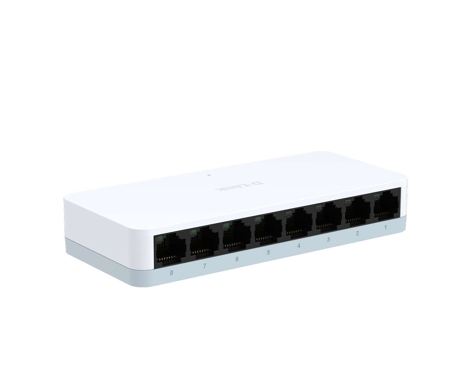

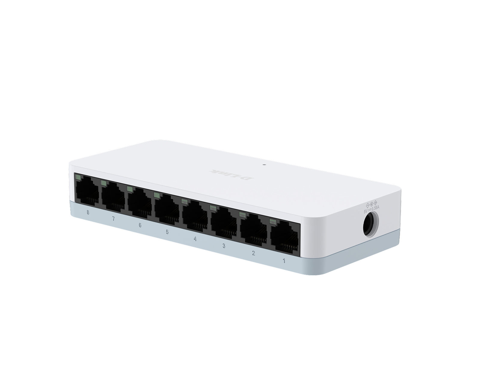

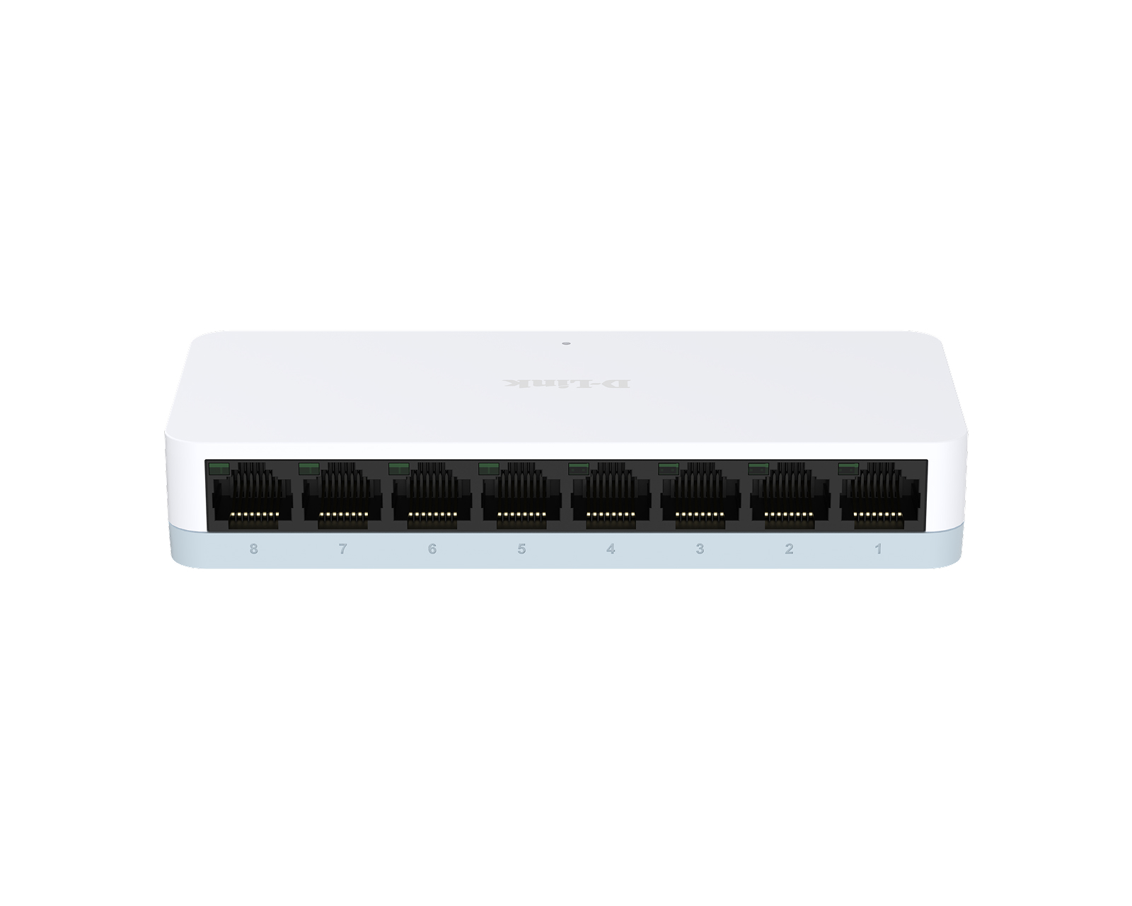

DES-1008C/С/1A
Back view
Front view
View from the right
View from the right
Left side view
