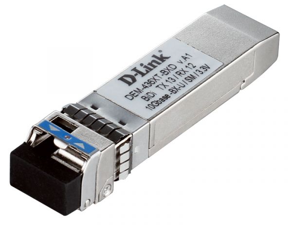

10GBase-ER (Tx:1330 nm, Rx:1270 nm) Single-Mode WDM SFP transceiver (up to 40 km)
Nereden AlınırTanımlama
Note: The DEM-436XT-BXD transceiver operates on a distance of up to 40 km. Operation on shorter disctances is possible only with the use of attenuator (not included in package contents).
D-Link’s 10G SFP+ Module series are hot-swappable transceivers designed for insertion in SFP+ slots of network devices for transmission and reception of data signals on the fber cables. These transceivers provide the 10 Gigabit operation to deliver the speed, reliable long-distance data transfer, and deployment fexibility that today fiber networks require.
Hot Swappable
All D-Link transceivers are hot-swappable. You can remove or replace the transceiver while the system is powered on without causing any problems. This permits modules to be added or swapped without interrupting the network.
10 Gigabit Ethernet speeds
The transceivers support 10 Gigabit Ethernet, which results in very fast data transmissions of up to 10 Gbit/s, that enables the switches to handle fast and heavy data transmissions, making it suitable for business needs.
Bi-directional WDM transmission
Bi-directional WDM transmission allows data to be transmitted and received simultaneously in both directions over a fiber cable. This helps to save on the costs of deploying extra fiber cables and allows for more flexible bandwidth allocation.
Genel Özellikler
Standard
• IEEE 802.3ae 10GBase-ER
Wavelength
• Tx: 1330 nm, Rx: 1270 nm
Data Rate
• 10 Gbps
Connector
• Simplex LC
Fiber Type
• 9/125 um Single-mode Fiber
Maximum Fiber Cable Length
• 40 km*
Transmit Power Range
• 5 to 0 dBm
Receive Power Range
• -7 to -21 dBm
Sensitivity
• -18 dBm
Polish Type
• UPC
Supported Features
• Hot swap
• MSA compliant
• RoHS compliant
Physical Parameters
Power Support
• 3.3 V
Power Consumption
• 1.5 W (max.)
Supply Current
• 430 mA (max.)
Heat Generated
• 5,35 kJ/h (max.)
Maximum Power Budget
• 26 dBm
Minimum Power Budget
• 21 dBm
Temperature
• Operating: 0В° to 70В°C
• Storage: -40В° to 85В°C
Humidity
• Operating: 0% to 85%
• Storage: 0% to 95%
Dimensions
• 57.5 mm x 14 mm x 8.55 mm
EMI
• CE
• FCC
• VCCI
Safety
• UL
• TUV
• CDRH
* Operation on shorter disctances is possible only with the use of attenuator (not included in package contents).
