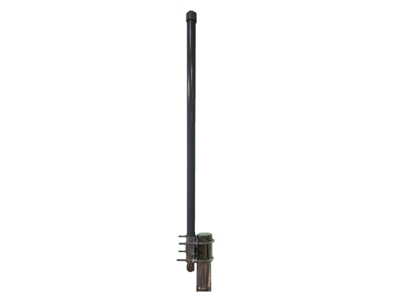

The ANT70-0800 outdoor omni-directional antenna operates both in 2.4 GHz and 5 GHz frequency bands, has 8 dBi (2.4 GHz) / 10 dBi (5 GHz) gain and N Plug connector.
The ANT70-0800 antenna connects to a wireless device equipped with detachable external antennas, for example access point or router. The 8/10 dBi ANT70-0800 antenna allows you to extend the 2.4 GHz or 5 GHz wireless network coverage and improve the quality of signal reception/transmission. This antenna is suitable both for outdoor and indoor use. Wide range of operating temperatures (-40 to 80 В°C) allows you to use the antenna in harsh environmental conditions. N type connector provides compatibility with the most of outdoor access points, while the optional N Jack & RP-SMA Plug cable allows you to connect the ANT70-0800 to indoor wireless devices.
The ANT70-0800 is ideal for using a wireless device in the Point-to-Multipoint WDS mode. This antenna provides the extension of your local area network (LAN) by connecting LANs at two physically separated locations. Alternatively, Wireless Internet Service Provider (WISP) subscribers can also use this antenna to establish a strong connection between their host and their ISP’s outdoor access point.
