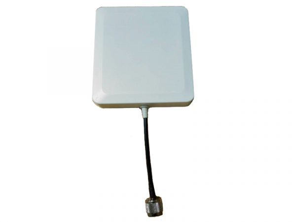

The ANT24-0801 outdoor directional antenna with 8 dBi gain operates in 2.3 - 2.5 GHz frequency band and has N Plug connector.
The ANT24-0801 antenna connects to a wireless device equipped with detachable external antennas, for example access point or router. Standard detachable antennas usually have lesser gain than the ANT24-0801, therefore using the 8 dBi ANT24-0801 antenna allows you to extend the 2.4 GHz wireless network coverage and improve the quality of signal reception/transmission.
This antenna is suitable
both for outdoor and indoor use. Wide range of operating temperatures (-40 to 80 В°C) allows you to use the antenna in harsh environmental conditions. N type connector provides compatibility with the most of outdoor access points, while the optional N Jack & RP-SMA Plug cable allows you to connect the ANT24-0801 to indoor wireless devices.

ANT24-0801/B
Front view
