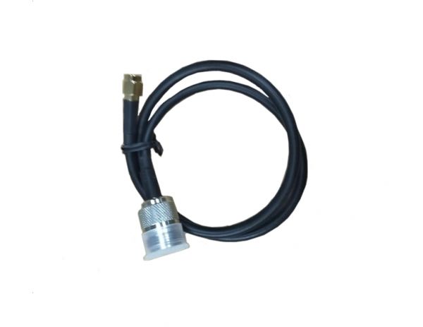

The ANT24-CB01N LMR-200 low loss conversion cable with N Jack and RP-SMA Plug connectors is designed for connecting external antenna to indoor wireless device. This cable can be used with the antennas operating both in 2.4 GHz and 5 GHz frequency ranges. The nominal impedance of the ANT24-CB01N is 50 Ohms.
A lot of wireless devices, such as access points and routers, are equipped with detachable antennas. To extend the wireless network coverage you can replace them with the antennas that have higher gain. The 0.5 m length ANT24-CB01N cable allows you to connect an external antenna with N Plug connector to an indoor wireless device with RP-SMA Jack connector. This conversion cable is suitable both for outdoor and indoor use. Wide range of operating temperatures (-40 to 85 °C) allows you to use the conversion cable in harsh environmental conditions.

Cable type
• LMR-200
Connectors
• N Jack & RP-SMA Plug
Operating frequency range
• 2.4 GHz
• 5 GHz
Impedance
• 50 Ohms
Cable jacket
• Black polyethylene
Cable length
• 3 m
Minimum bend radius
• 12.7 mm
Environment
• Outdoor / Indoor
Operating temperature
• -40 to 85 °C
