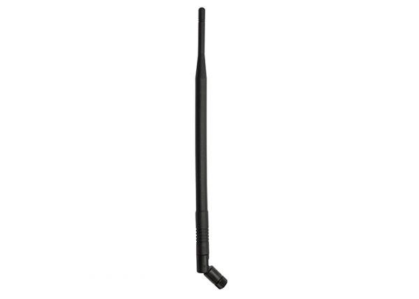

The ANT24-0802C omni-directional antenna with 8 dBi gain operates in 2.4 - 2.5 GHz frequency band and has RP-SMA Plug connector.
The ANT24-0802C antenna connects to a wireless device equipped with detachable antennas, for example access point or router. The 8 dBi ANT24-0802C antenna allows you to extend the 2.4 GHz wireless network coverage and improve the quality of signal reception/transmission. This antenna is designed for indoor use.
