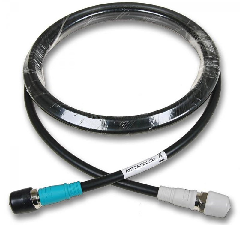

ANT24-ODU3M  Antenna Cable Kit With 3-m Extension Cable
Görseller
ANT24-ODU3M/Ax
Front view
